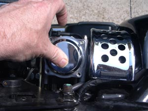

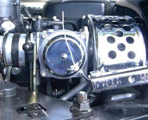

It is NOT necessary to remove the carbs to shim them, just remove the seat, console and gas tank.

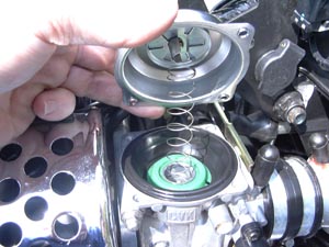

Remove the four screws from the tops of each carb. There is spring pressure on the tops so you need to hold the top as you remove the last screw.
Be careful you do not disturb the black rubber diaphram, this needs to be perfectly aligned when you re-assemble the tops.
