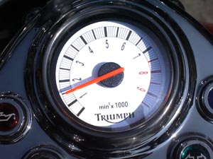

Warm up the bike first then set your idle, using the black idle set knob, to around 1500rpm.
