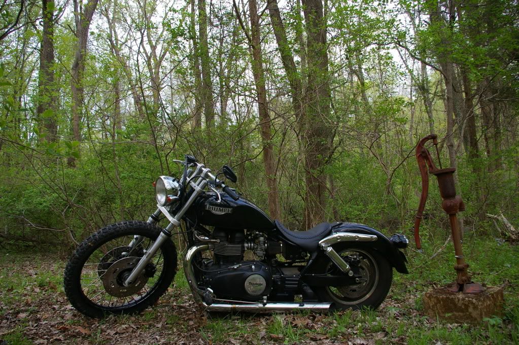

i say try it & see if you like it- i ran this way for a while with no probs-

Re: Lowering the front? [Re: hutchjr7]
      #556744 - 04/18/12 07:20 PM
yup i would say those were pretty low :-) thanks for the pic
That's a bit more than I was looking for. BTW - did you have to shorten you kick stand?
I'm just trying to get it level again. I'm thinking an inch would do it. But, at least this way if it needs a little more, there no problem in dropping her a little more.

      #556813 - 04/19/12 09:58 AM
The progressive kit allows you lower 1" or 2"- whichever you desire- and yes woody, the kickstand was bent/cut shorter-
