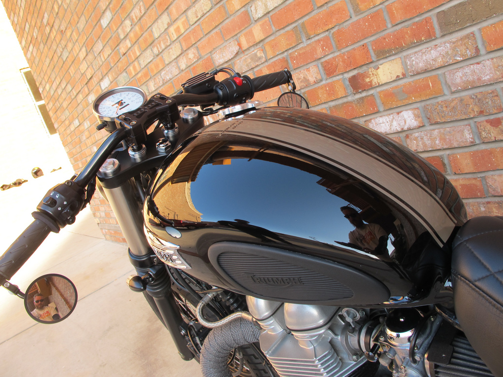

The two biggest contributors to this makeover are the Thruxton tank (who knew that would be a direct bolt-up?) and the reworked Kawasaki Ninja mid/rear sets. The holes where the forwards used to be have been plugged with some custom lathe-turned pieces, and the Kawi controls look damn near factory.
Forks: 41mm stock forks. Progressive lowering kit (roughly 2 inches); shaved lowers and powder coated
Chassis mods: Very slight frame modification to accept an ’06 Thruxton tank; Vortex CNC Kawasaki Ninja rearsets
Tire/wheel size and style: Front: 18 x 2.5 120/90 36 spoke; rear: 15 x 3.5 170/80 40 spoke. Stock hubs and rims powder coated
Other mods, accessories, cool parts, etc: I love my upside down Biltwell Trackers. Joker Machine bar clamps, reservoir cover, choke and front sprocket cover. Sportbike CNC bar end mirrors. Progressive front lowering kit and 11.5″ rear adjustable shocks. Custom seat by Manuel at Sweetwater Marine
